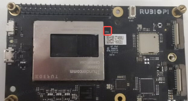

May we kindly confirm whether you are currently using the V01 or V02 device?
@kinkin i have the v2 version
