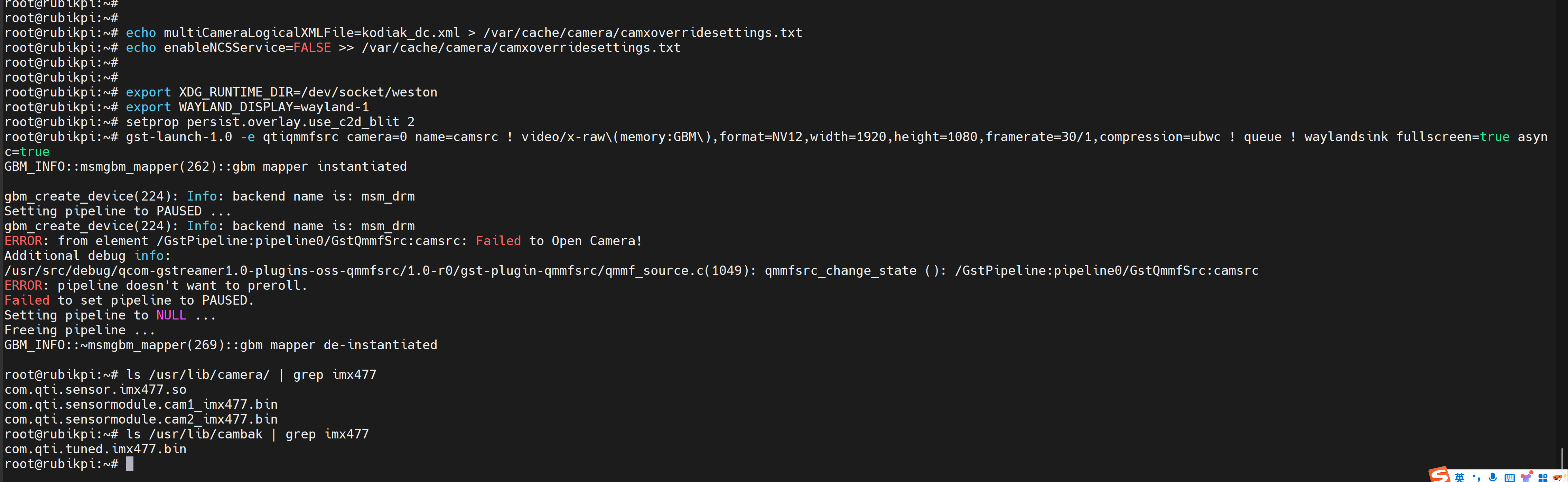

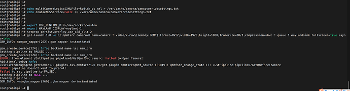

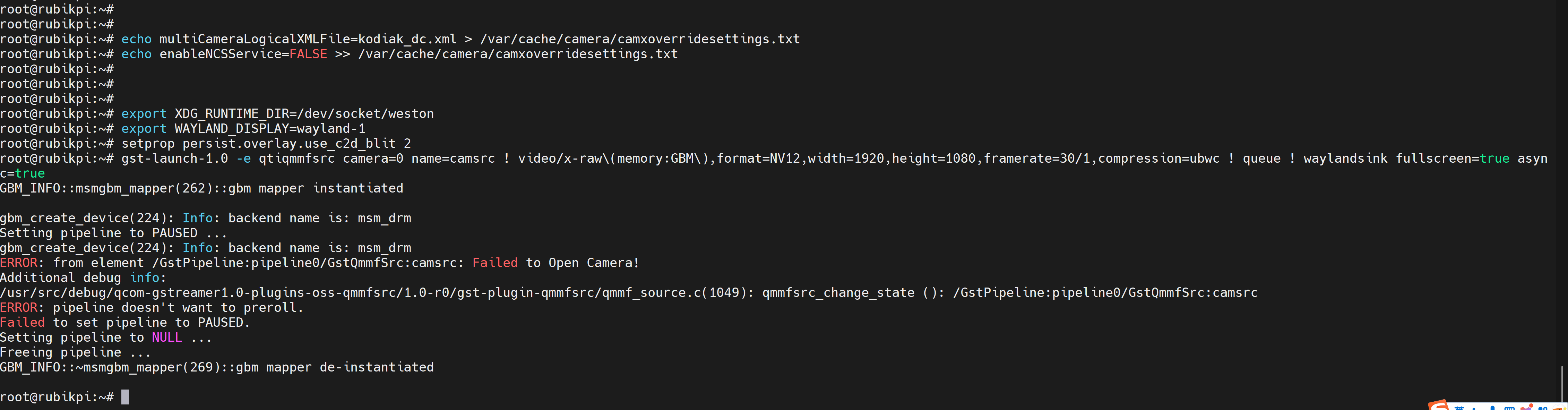

root@rubikpi:~# echo multiCameraLogicalXMLFile=kodiak_dc.xml > /var/cache/camera/camxoverridesettings.txt
root@rubikpi:~# echo enableNCSService=FALSE >> /var/cache/camera/camxoverridesettings.txt
root@rubikpi:~#
root@rubikpi:~#
root@rubikpi:~# export XDG_RUNTIME_DIR=/dev/socket/weston
root@rubikpi:~# export WAYLAND_DISPLAY=wayland-1
root@rubikpi:~# setprop persist.overlay.use_c2d_blit 2
root@rubikpi:~# gst-launch-1.0 -e qtiqmmfsrc camera=0 name=camsrc ! video/x-raw(memory:GBM),format=NV12,width=1920,height=1080,framerate=30/1,compression=ubwc ! queue ! waylandsink fullscreen=true async=true
GBM_INFO::msmgbm_mapper(262)::gbm mapper instantiated
gbm_create_device(224): Info: backend name is: msm_drm
Setting pipeline to PAUSED …
ERROR: from element /GstPipeline:pipeline0/GstQmmfSrc:camsrc: Failed to Open Camera!
Additional debug info:
/usr/src/debug/qcom-gstreamer1.0-plugins-oss-qmmfsrc/1.0-r0/gst-plugin-qmmfsrc/qmmf_source.c(1049): qmmfsrc_change_state (): /GstPipeline:pipeline0/GstQmmfSrc:camsrc
ERROR: pipeline doesn’t want to preroll.
Failed to set pipeline to PAUSED.
Setting pipeline to NULL …
Freeing pipeline …
GBM_INFO::~msmgbm_mapper(269)::gbm mapper de-instantiated
root@rubikpi:~#

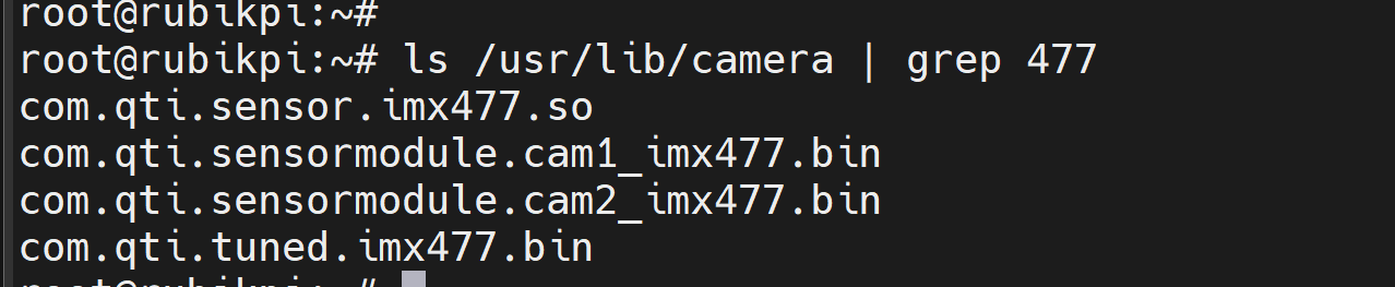

Based on the logs, it appears that the camera has not been recognized.
Please run the following command and upload the screenshot.
ls /usr/lib/camera | grep 477

Please push these two files to the /usr/lib/camera directory, then restart and try again.

Please move the com.qti.tuned.imx477.bin file from the /usr/lib/camera directory to another location, and ensure that this bin file is not present in the /usr/lib/camera directory.
Then restart and try again.
Still not working
