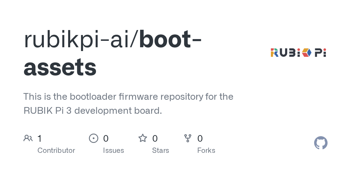

Please replace the following images in the image package, flash them to the board, and then proceed with testing.
@kinkin Thanks for your reply! This sounds promising, but I’m not exactly what to do here. Do you have any more information about the specific procedure to follow by any chance?
You may download the latest Ubuntu image via the link below,
https://ubuntu.com/download/qualcomm-iot#rubikpi3
replace the relevant image files with those provided in the GitHub link,
and then flash the image to the development board for testing.
Please refer to the following link for flashing instructions.

@Robert - did you ever get to the bottom of this? We are also experiencing the exact same issue (auto-boot does not work after board has been powered down for > 30 seconds). Different variants on the boot firmware (including the latest on rubikpi-ai/boot-assets) make no difference.
Would be delighted to hear any wisdom you gathered on this. Thank you!
