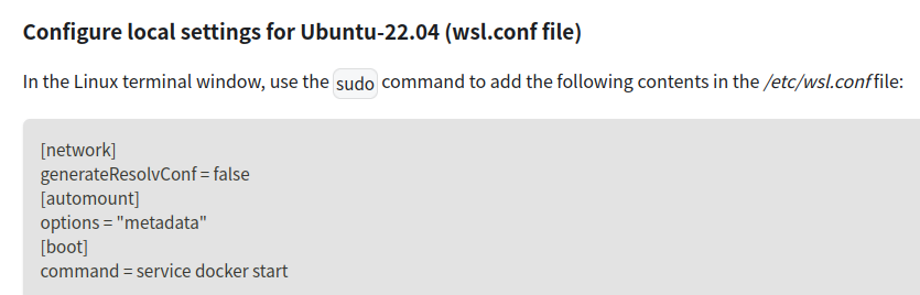

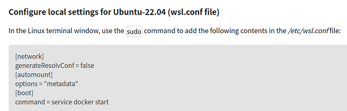

  2. Your shared WSL instructions are not applicable.
    Rubik Pi does not run WSL. Editing /etc/wsl.conf on a PC has no impact on kernel modules inside Rubik Pi’s Debian image.
