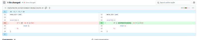

In the Yocto project, when executing the rubikpi_build.sh -a command, the script does not terminate upon errors in critical bitbake commands. This condition prevents the ./rubikpi_build.sh --zip_flat_build command from packaging images in certain scenarios.
  • Problem analysis:
In BASH shell, $? is commonly used to retrieve the exit code of the last executed command. However, for pipeline commands, $? only captures the exit code of the last command in the pipeline.
In rubikpi_build.sh, the following function has problems. Even if the bitbake command fails, the assert function will not detect it.
assert() {
        if [ $? -ne 0 ];then
                exit 1;
        fi
echo "bitbake qcom-multimedia-image" 2>&1 | tee -a $log_file
bitbake qcom-multimedia-image 2>&1 | tee -a $log_file
assert
echo "bitbake qcom-qim-product-sdk" 2>&1 | tee -a $log_file
assert
