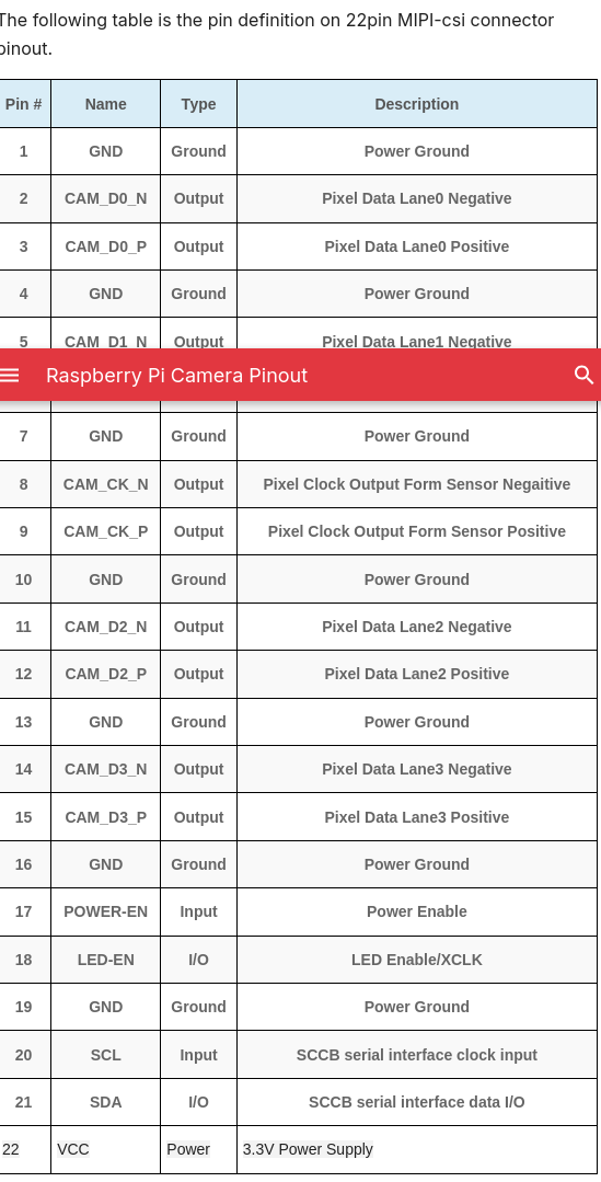

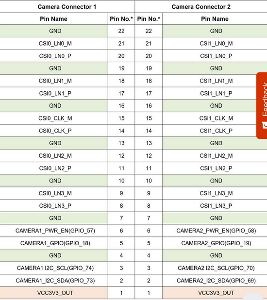

Hello I realised the V1.2 of the datasheet seems to have reverse polarity of the pin connectors from RPi5 standard. Can you please confirm ?
Hi Please specify the exact location of the pin connectors’ polarity. Please clarify the component position marked as Rpi5.
Refer to my question
