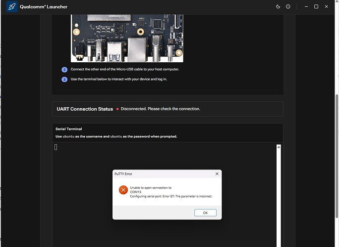

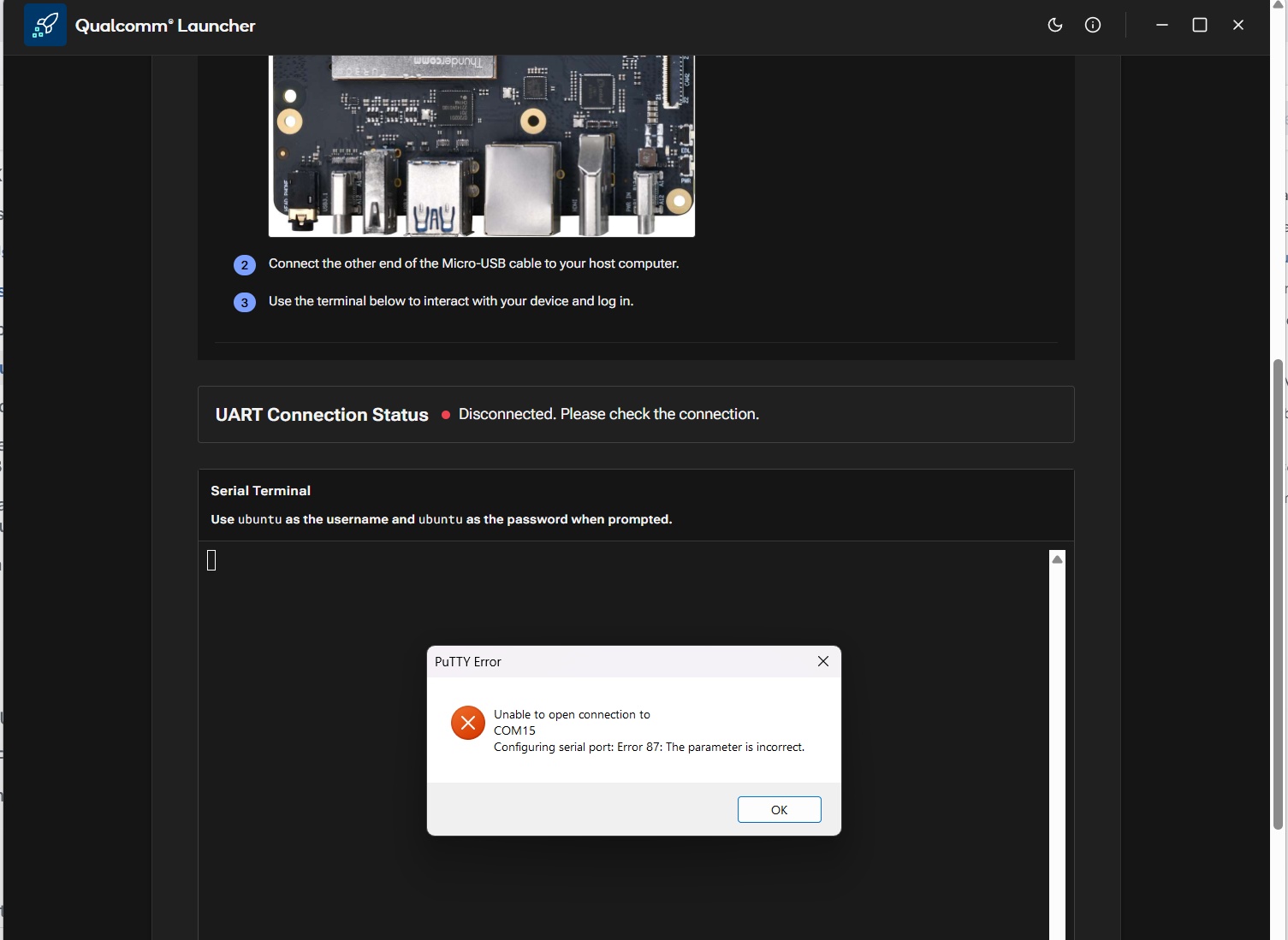

  3. After flashing successfully, the Debug Uart port could not be connected as attached file. I tried to open the console by Putty but I got the error message: “Unable to open the connection to COM15. Configuring serial port: Error 87: The parameter is incorrect.”

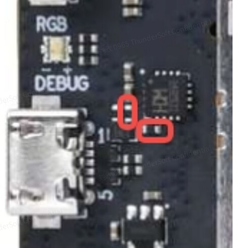

We recommend using an oscilloscope to check for signal output at the location marked by the red box in the image (UART_TX / UART_RX).
