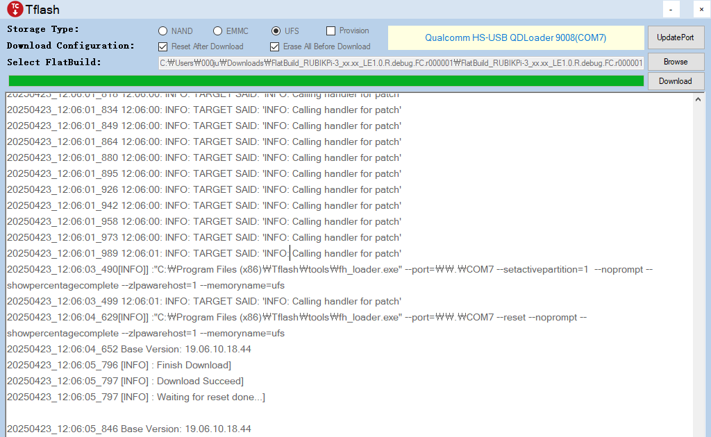

I recently downloaded the RUBIK Pi 3 Linux System Image ver 1.0 zip file and flashed it using the TFlash method on my Windows PC, following the instructions provided in the “Get Started” manual.
The flashing process appeared to complete successfully. The log output showed the following messages:
20250423_12:06:04_652 Base Version: 19.06.10.18.44
20250423_12:06:05_796 [INFO] : Finish Download]
20250423_12:06:05_797 [INFO] : Download Succeed]
20250423_12:06:05_797 [INFO] : Waiting for reset done...]
20250423_12:06:05_846 Base Version: 19.06.10.18.44
