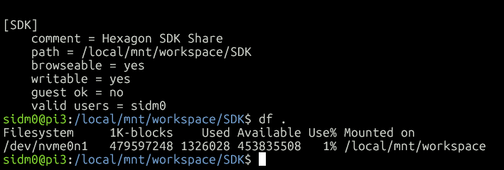

SAMBA
Setup On Windows Machine (Assumes SDK is at c:\Qualcomm\Hexagon_SDK\6.5.0.0)
  • Mount the remote filesystem:
  • pushd \pi3\SDK
Now z: will map to pi3:/local/mnt/workspace/SDK. Could be a different letter:
