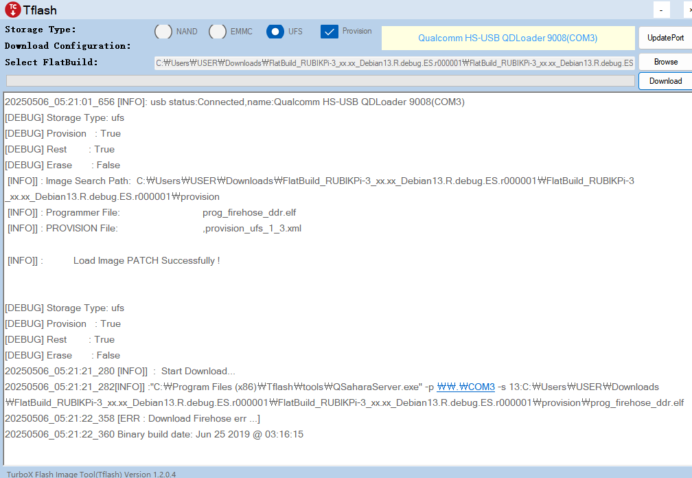

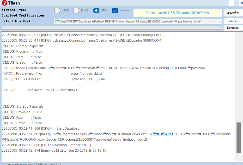

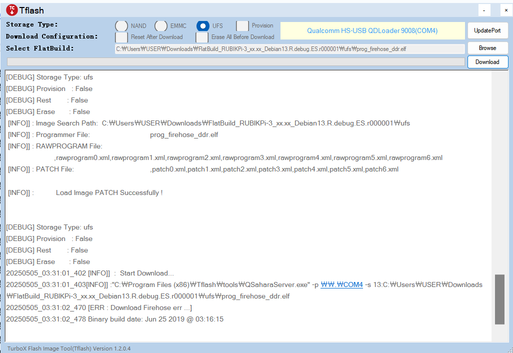

I’m following the Rubik Pi 3 Quick Start guide (section 1.3.3) to flash Debian, but I always get the same error in both the original Tflash and the new TurboX Easy Flash (v1.1.3):
What I’ve tried:
- In the GUI I selected download type: flatbuild, storage: ufs, and Provision ON.
- I confirmed “Qualcomm HS-USB QDLoader 9008 (COM4)” is detected in Device Manager.
- I also ran the firehose tool manually:
- & ‘C:\Program Files (x86)\Tflash\tools\QSaharaServer.exe’
-p '\\.\COM4'
-s “13:C:\Users\USER\Downloads\FlatBuild_RUBIKPi-3_xx.xx_Debian13.R.debug.ES.r000001\ufs\prog_firehose_ddr.elf”
ERROR: function: main:314 Could not connect to \.\COM4
Questions:
What is causing the “Download Firehose err”?
Is there an alternative recommended tool or method for flashing Debian 13 on Rubik Pi 3?
