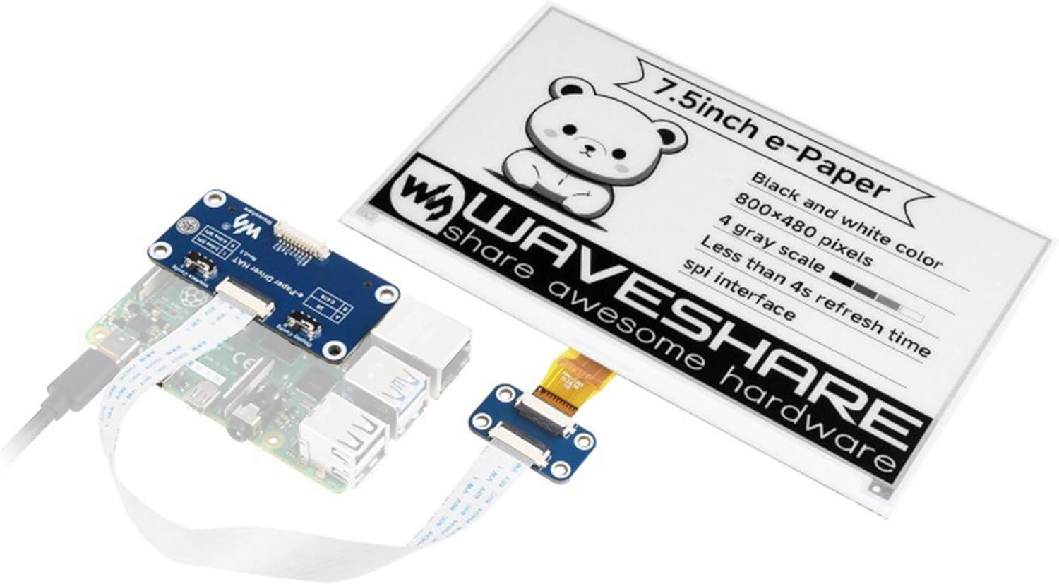

I am using the python periphery library to drive an eink display. currently I have to run my code with sudo permission everytime. I would like to give my user permanent gpio and spi permission. I know on Rpi 5 there are user groups for that.
How can I give my user permission on Rubik Pi 3?
May I know the details for the eink display and how you connect to Rubik Pi 3?
Seems like it’s not simply a permission question.
It might need additional configuration for the 40-pin connector.
Yes this is a SPI display with 40-pin connector
RubikPi can be connected to the SPI display via the 40-pin connector; you may proceed with the relevant adaptation work.
