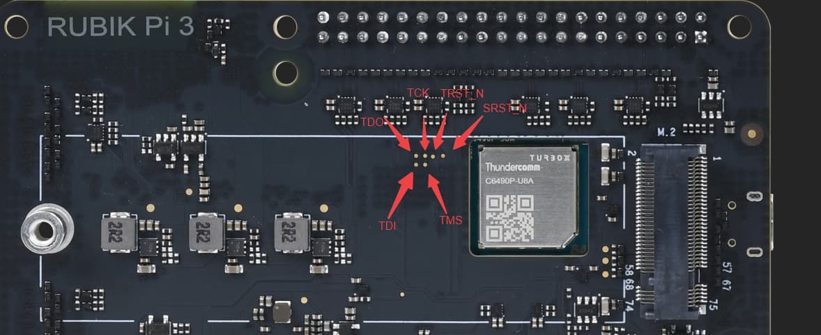

Hello,
there should be some connector/TPs that allow to connect the JTAG debugger for low level debugging.
Could you point me where to find it and perhaps the setup for the Lauterbach Power Debug probe?

We have just concluded our holiday period, and we apologize for the delayed response.
Please refer to the images below.
