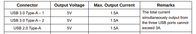

The voltage and current output from the USB ports:
Could you kindly advise how you determined that “these ports don’t seem to output power”?
Additionally, have you connected any peripherals such as a display, speakers, or other devices to the USB interfaces? Does it function normally when a mouse and keyboard are attached?
Given that both USB-A and USB-C ports exhibit the same behavior, the cause is most likely unrelated to power-on timing.
