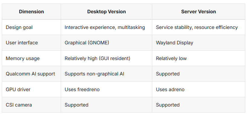

I am planning to use Rubik Pi for AI education purposes with students, and would like to understand the differences between the Ubuntu Desktop version and the Server version.
According to the Rubik Pi documentation, the Desktop version states “Qualcomm AI support – Supports non-graphical AI”, while the Server version states “Qualcomm AI support – Supported”. It would be helpful to have additional clarification on this distinction. Specifically, what is meant by “graphical AI”, and what features are not supported in the Desktop version?
In addition, the documentation indicates that the Desktop version “uses freedreno” for the GPU driver, while the Server version “uses adreno”. Do both the Desktop and Server versions support GPU acceleration for AI model inference?
