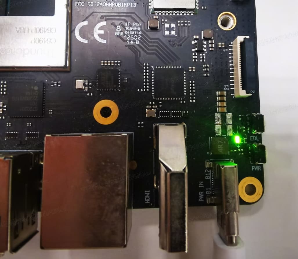

In addition, you may check whether the power indicator LED on the board lights up as shown in the image after power‑up.
If the indicator lights up normally, this means the power supply meets specifications and power negotiation is successful.
