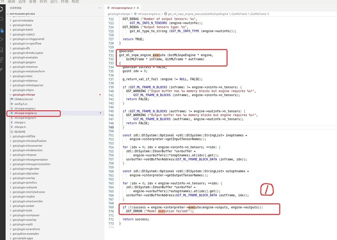

Dear customer,we are currently syncing this issue internally.
Before and after the function ①, obtaining the timestamps and calculating the difference will provide the exact inference time.
Okay I will try it, thank you
This is the time of the model inference itself, but what if I want to get the time of total processing of one frame with pre and post processing included

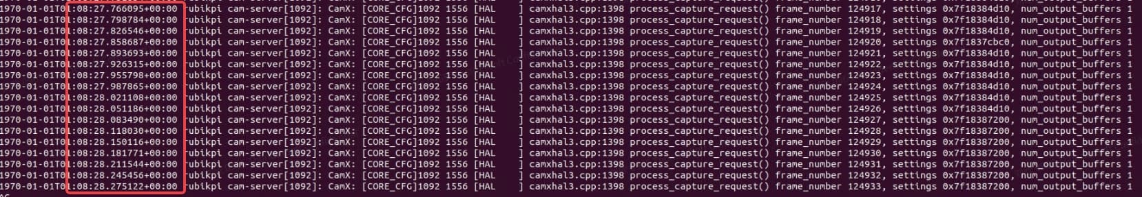

What does “total processing time” specifically refer to? Is it the time from when a frame request command is issued until the display is completed (including inference time)?
I mean the time from issuing the frame request command to getting the coordinates of the bounding boxes, because let’s say I don’t need a display, which in itself takes some time.
One terminal executes object detection, while another terminal executes the following commands to obtain the time of issuing the frame request command:
journalctl -o short-iso-precise -f  | grep process_capture_request
for example:
After function ①, obtain the time of getting the coordinates of the bounding boxes.
