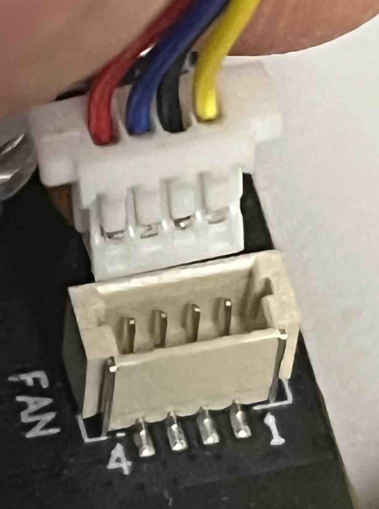

It appears the silkscreen on the fan connector is mislabeled. The pin 1 and pin 4 labels seem swapped. Isn’t pin 1 on the JST-SH connector the red wire?

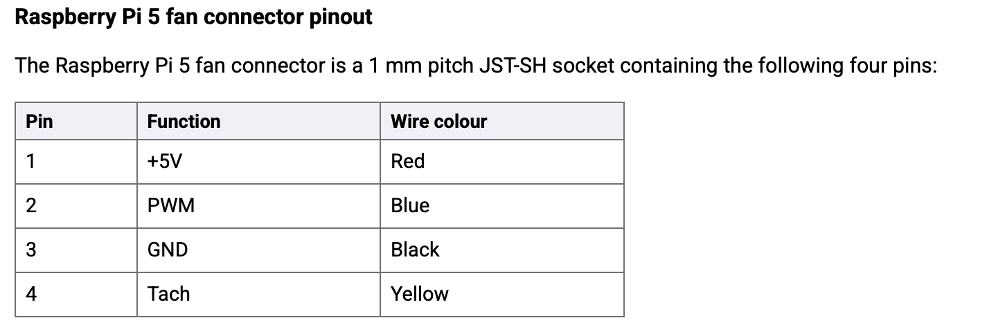

My point above is your “silkscreen labels” appear to be incorrect for the fan connector. The pin 1 and 4 labels are reversed. The connector is wired correctly, but the silkscreen is in error. Below is the raspberry pi 5 fanout pinout from their website. Let me know if my understanding is incorrect, or your silkscreen labels are wrong.
We are currently syncing this issue internally.
The RUBIK Pi design takes the Raspberry Pi as a reference but is not identical. For further details, please consult the schematic (Page 16, “FAN Connector”) via the link below.
