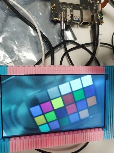

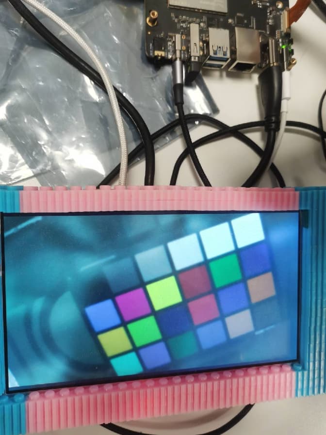

If the issue persists, please upload a photo of the Rubik Pi connected to the camera.
If there are any further developments, please also inform us.
Connect to camera2 interface is ok and connect to camera1 interface is not work
