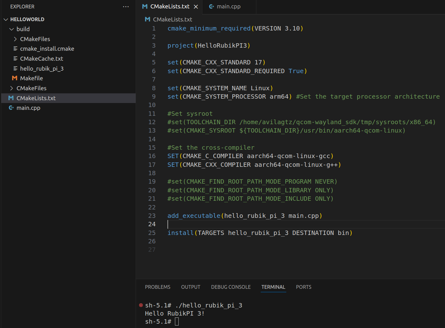

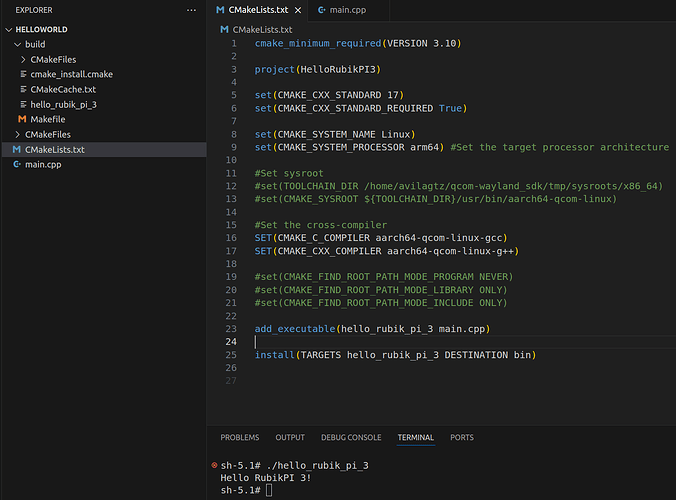

The only way to make it work:
cmake_minimum_required(VERSION 3.10)
#Set sysroot
#set(TOOLCHAIN_DIR /home/avilagtz/qcom-wayland_sdk/tmp/sysroots/x86_64)
#set(CMAKE_SYSROOT ${TOOLCHAIN_DIR}/usr/bin/aarch64-qcom-linux)
#Set the cross-compiler
SET(CMAKE_C_COMPILER aarch64-qcom-linux-gcc)
SET(CMAKE_CXX_COMPILER aarch64-qcom-linux-g++)
#set(CMAKE_FIND_ROOT_PATH_MODE_PROGRAM NEVER)
#set(CMAKE_FIND_ROOT_PATH_MODE_LIBRARY ONLY)
#set(CMAKE_FIND_ROOT_PATH_MODE_INCLUDE ONLY)
I can execute the binary on the board with QCOM Linux but my question is, by doing this cmake modification I’m losing important features? As for now is a very simple code but I’m wondering if I’m following the right way:
Current basic code:
