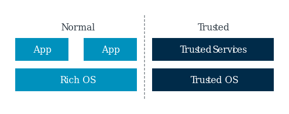

Are you inquiring about the Trusted Execution Environment (TEE) on the Qualcomm platform?
The 6490 chipset inherently supports this functionality, eliminating the need for an additional chip.
You may refer to this document for further information:
Yes I’m asking about the TEE. Mainly if the Trusted part Trusted OS, if it’s locked down or can be build from source? The question is connected to the trusted services - trustlets - that usually require to be signed in order to be loaded.
I assume also from the Trusted side it’s possible to control the QFPROM fuses.
