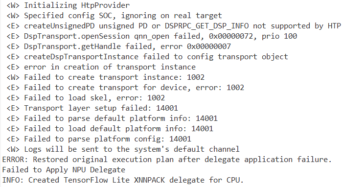

Below are the logs when using kHtpBackend.

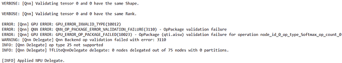

Logs when kGpuBackend is selected.

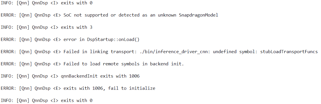

Logs when kDspBackend is selected.

First, I ran qnn-platform-validator on my current environment (Debian 13) to test QNN.
The DSP unit test failed with the following output:
PF_VALIDATOR: DEBUG: Starting calculator test
PF_VALIDATOR: DEBUG: Loading sample stub: libQnnHtpV68CalculatorStub.so
PF_VALIDATOR: DEBUG: Successfully loaded DSP library - ‘libQnnHtpV68CalculatorStub.so’. Setting up pointers.
PF_VALIDATOR: ERROR: -2 . Error while executing the sum function.
PF_VALIDATOR: ERROR: Please use testsig if using unsigned images.
PF_VALIDATOR: ERROR: Also make sure ADSP_LIBRARY_PATH points to directory containing skels.
Unit Test on the backend DSP: Failed.
QNN is NOT supported for backend DSP on the device.

Based on this output, does it mean that the DSP backend is currently not supported on Debian 13?

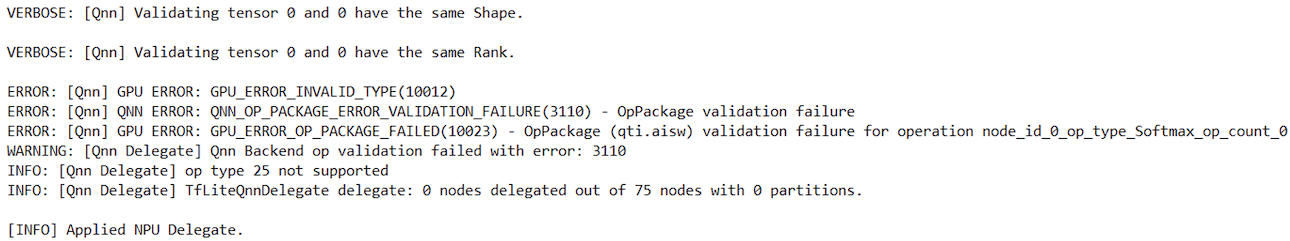

I also tested using the kGpuBackend option, but in this case no operators were offloaded, and the following errors were observed:
ERROR: [Qnn] GPU ERROR: GPU_ERROR_INVALID_TYPE(10012)
ERROR: [Qnn] QNN ERROR: QNN_OP_PACKAGE_ERROR_VALIDATION_FAILURE(3110) - OpPackage validation failure
ERROR: [Qnn] GPU ERROR: GPU_ERROR_OP_PACKAGE_FAILED(10023) - OpPackage (qti.aisw) validation failure for operation node_id_0_op_type_Pad_op_count_0

QNN support for the Debian image is currently under development and will be released together with the next version.
