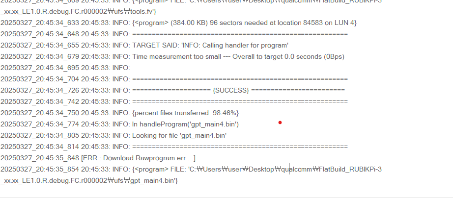

While downloading linux 1.1 version in Rubic Pi3, log comes out like this. I don’t know how to solve problem.
1.May I confirm whether the customer is using the Tflash tool for flashing?
2.Where did the customer obtain the firmware package for flashing? Was it provided by TC?
3.Could the customer please share the configuration of the flash tool?
Have you tried the methods in the document to provision UFS.
In version 1.1, we used the lun6 partition, but your default UFS configuration may not have enabled lun6.
Although I didn’t see any error with lun6, I think giving it a try might be helpful
