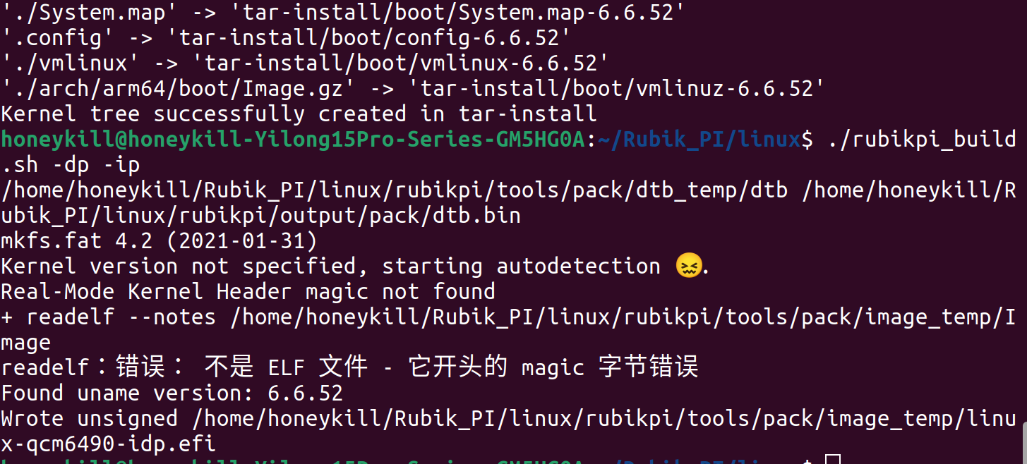

Why did I compile the kernel successfully, but get an error when packaging the image file? This is inconsistent with the documentation
I got exactly the same error.
This is a sign of successful packaging, and you can go to the path to see the update time of the product. So please don’t get me wrong, this will not affect the normal use of functions, and this will be improved in subsequent version updates.
