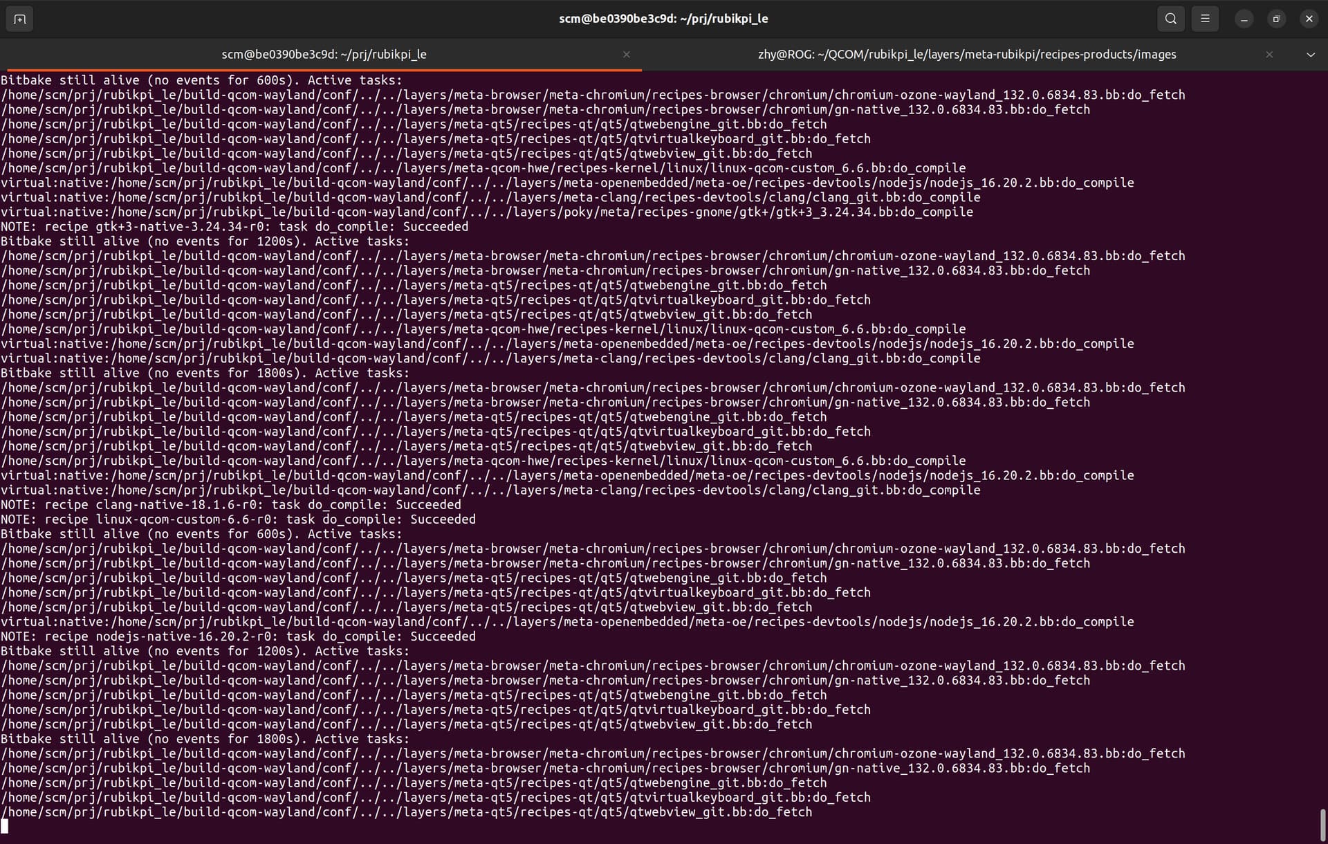

I want to reproduce the problem according to the steps you provided, but after compiling multiple times, I have been stuck in this step;
It seems to be a network issue, I am trying to find a solution to it.
Yes, I have been stuck like that before as well HY, I had to reboot and restart the build to proceed.

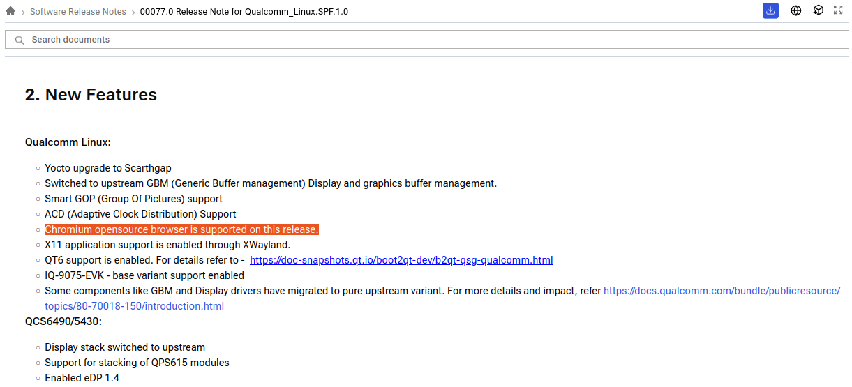

Qualcomm has released a new version that supports browsers, and we plan to upgrade to this version in the near future.
Oh, this is excellent news HY, thanks! I will wait for this update, no problem at all.
(I do see in that note that they have upgraded to Scarthgap, which is also good news, but I guess your meta layers will need to be checked because right now they are set to Kirkstone: meta-rubikpi/conf/layer.conf at main · rubikpi-ai/meta-rubikpi · GitHub )

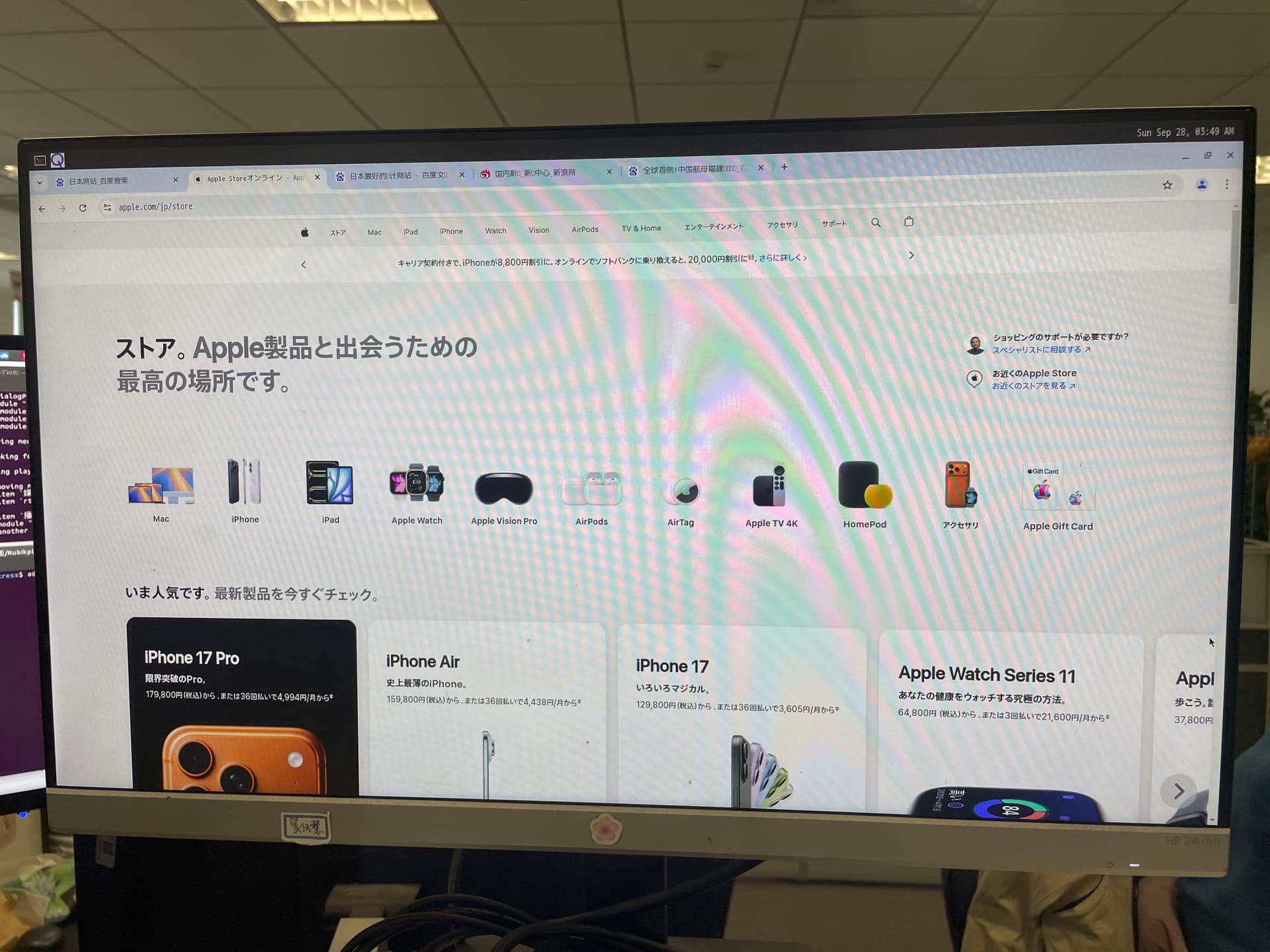

Hi @davidt ,
In the RUBIK Pi V1.2 Linux system (based on QLI1.5), I have enabled the Chromium browser.
It can currently browse Japanese websites and play videos, but GPU acceleration is not yet functional.
I am still debugging this issue. I will send you the current system image. I will also share my debugging process in a post soon.
Thank you.
